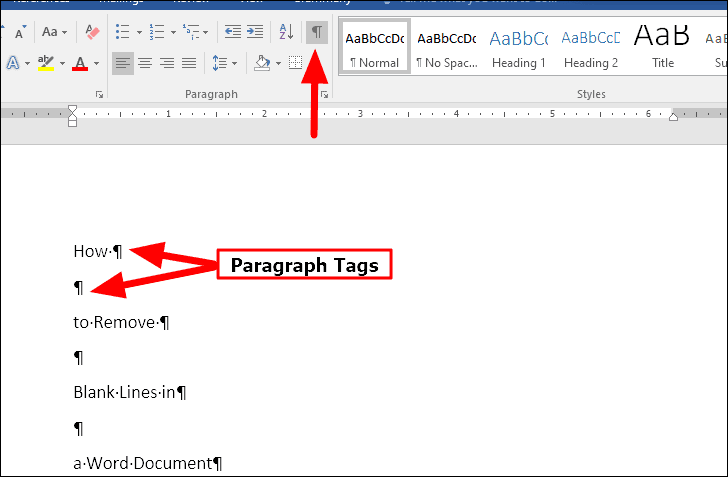

First, you’ll want to make sure you can see the paragraph markers in your document. To do this, just click the ‘Show/Hide ¶’ button on the Home tab. It looks like a backwards P. This lets you see exactly where those blank lines come from (double paragraph marks).

  2. In the “Find what” box, enter ^p^p. This tells Word to search for double paragraph markers, the source of the blank lines. In the “Replace with” box, enter ^p. This tells Word to replace double paragraph markers with a single paragraph marker.
