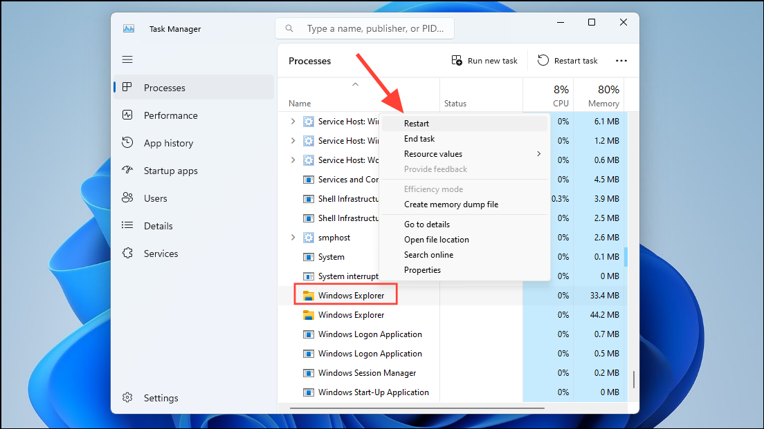

Reset Windows Explorer
Sometimes, the black screen isn’t a full system crash, but rather an issue with Windows Explorer. If you can see your mouse cursor, this might be the problem. Restarting Windows Explorer is an easy fix to try.
  1. Press Ctrl + Shift + Esc to launch Task Manager.
  2. In Task Manager, go to the “Processes” tab and find “Windows Explorer.” You can also use the search bar at the top if it is difficult to find.
  1. Right-click “Windows Explorer” and select “Restart.” Your screen might flicker briefly as it restarts.
This should refresh File Explorer and hopefully get rid of the black screen.
