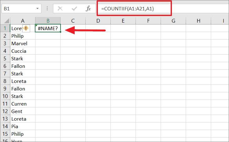

One of the most frequent reasons for a #NAME error is misspelling the function’s name or using a function that doesn’t exist. If you’ve typed the function name incorrectly, you’ll see the #NAME? error.
For example, here, the function to count an item’s repeat is misspelled as “COUNTIIF” instead of “COUNTIF”, causing the #NAME? error.
Correcting the spelling of the function will resolve the issue.
