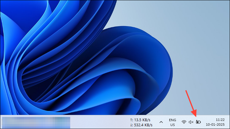

It’s not always practical to put your laptop to sleep every time you need to charge it. If that’s the case, try limiting what you do when it’s plugged in. Avoid heavy tasks like gaming or video editing as they use more power and will slow down charging. You can do lighter tasks and wait for the battery to get some charge before resuming your regular activities. Also, turn on airplane mode, lower the brightness, and close unnecessary background apps. This will help conserve power and speed up the charging process. Here’s how to enable power saving mode.
  1. Click on the battery icon on the lower right of your Windows PC.
  2. Then click on the ‘Energy Saver’ toggle in the pop-up menu to toggle it on.
