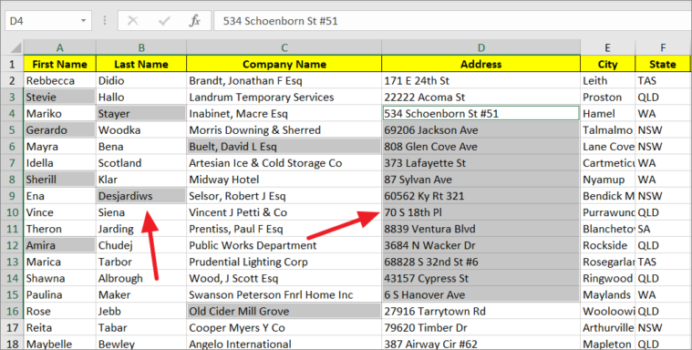

Method 1: Using the Keyboard and Mouse
Most of us are familiar with using a combination of the keyboard and mouse to select non-adjacent cells. It’s often the quickest and most intuitive method.
To do this, simply hold down the Ctrl key and then click each cell you want to select. You can also click and drag to select a range of cells while still holding the Ctrl key. Don’t let go of the Ctrl key until you have selected all the cells you need or you’ll lose your selection.
You can also select entire rows or columns this way. Just hold Ctrl and then click the column letter (like B or D) or the row number (like 5, 7, 10).
It is possible to select combinations of individual cells, full rows, and columns at once. If you accidentally select a cell or range you didn’t want, just keep Ctrl pressed and click the selected cells again to deselect them.
