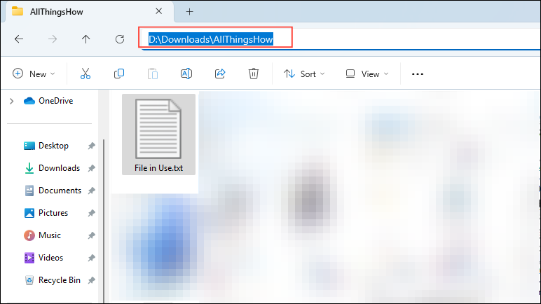

  1. First, head to the location of the file you’re trying to delete in File Explorer.
  2. Click in the address bar at the top of File Explorer to highlight the file path, then copy it (Ctrl + C).
