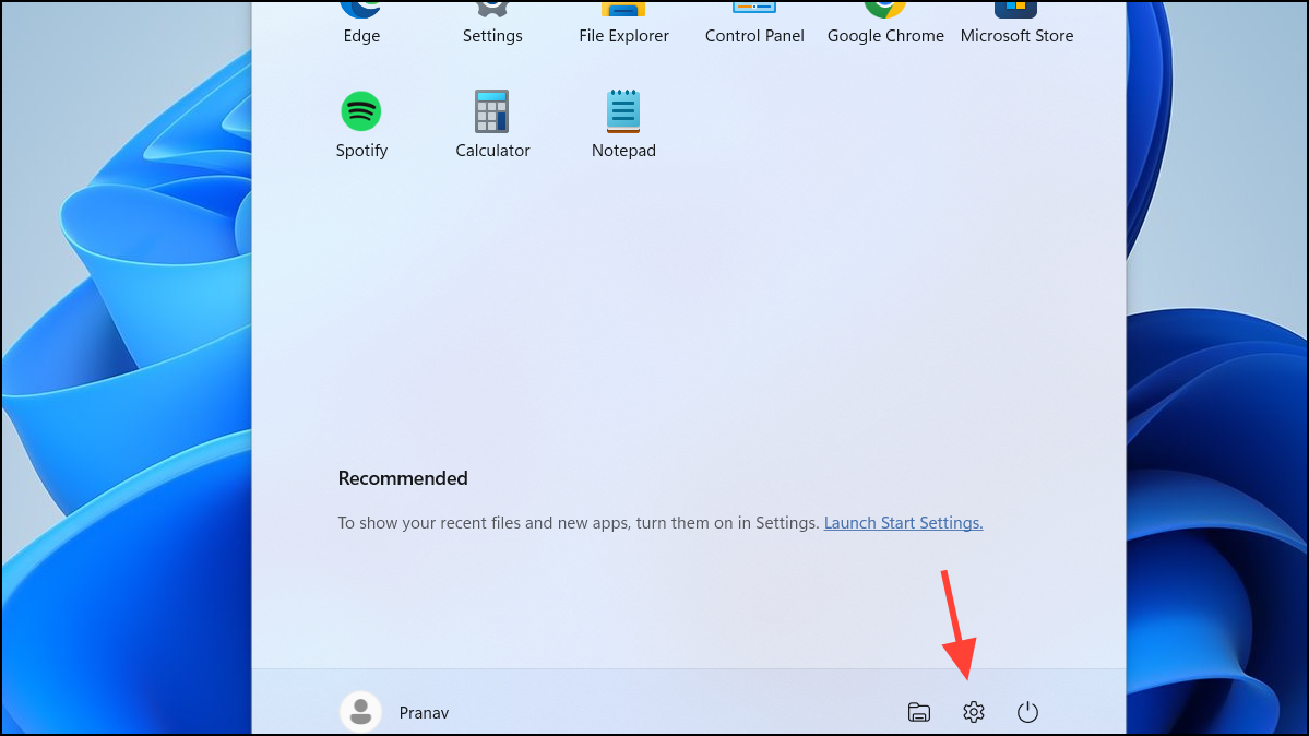

  1. Click the Start menu and then select the Settings app (it’s the gear icon).
