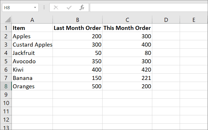

Let’s say we have a list of fruit orders, with column B showing last month’s orders and column C showing this month’s.
To calculate the percentage change in the number of apples ordered, enter the formula below in cell D2.
=(C2-B2)/B2
After entering the formula, hit Enter
. You’ll get a decimal result:
This isn’t yet formatted as a percentage. To fix that, select the cell, and click the ‘Percentage Style’ button in the ‘Number’ group under the ‘Home’ tab.
Now, the decimal will be displayed as a percentage:
