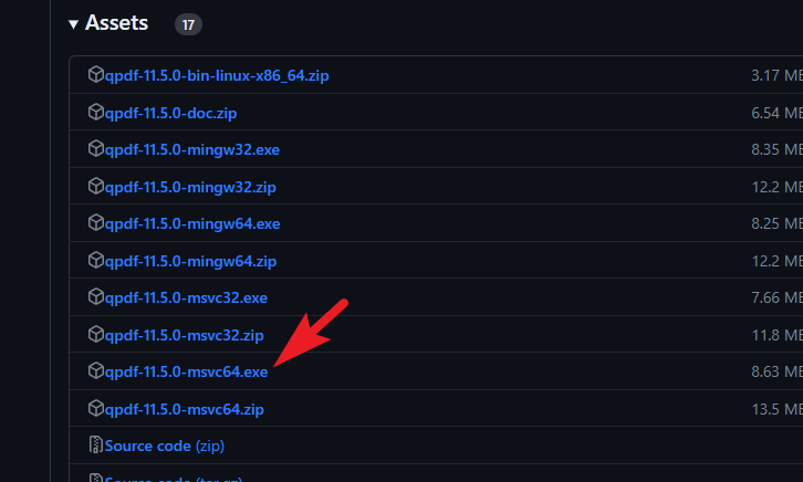

First, go to github.com/qpdf in your browser. Download the installer for your system: qpdf-msvc64.exe for 64-bit Windows or qpdf-msvc32.exe for 32-bit Windows.
After it’s done downloading, open your downloads folder and double-click the .EXE file to start the installation.
