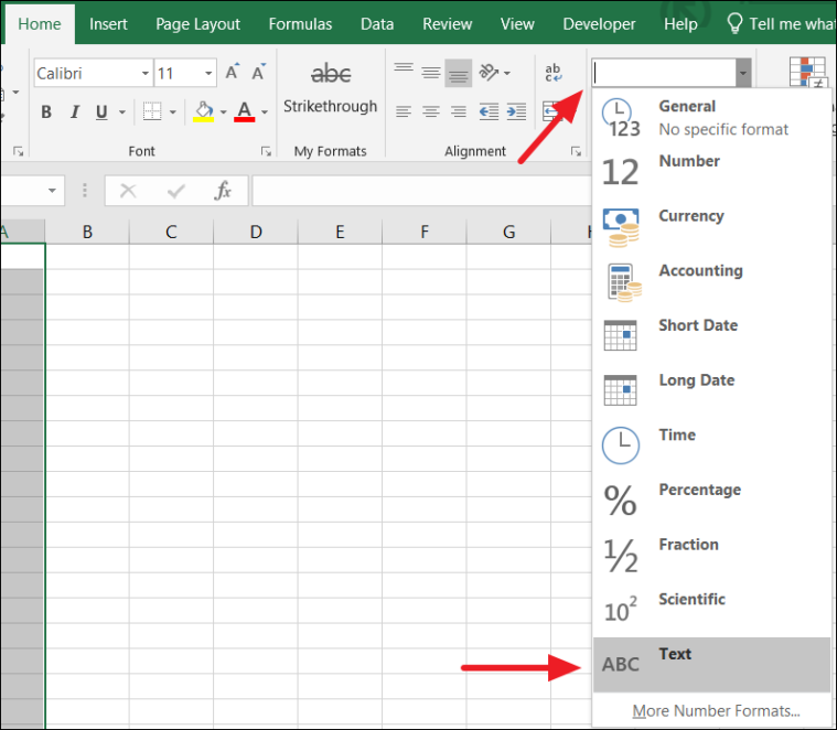

Changing the Cell Format to Text
This is a straightforward method for keeping leading zeros as you type. By changing a cell’s format to Text, you’re telling Excel to treat your entry as text, preserving it exactly as typed. Here’s how:
Select the cell(s), head to the ‘Home’ tab, find the ‘Format’ dropdown in the ‘Number’ group, and choose ‘Text’.
Now, Excel will keep any leading zeros you enter.
