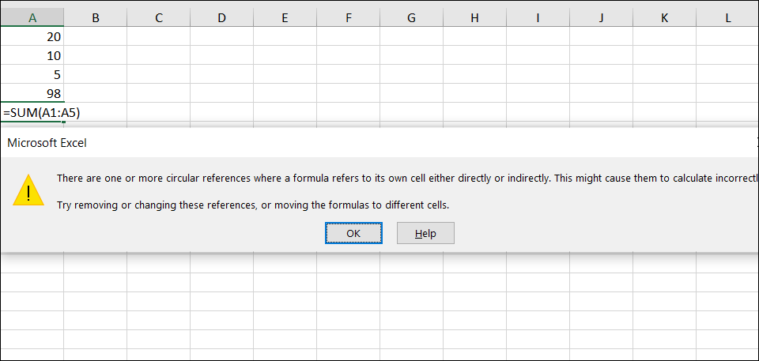

Imagine you’ve got numbers in cells A1 through A4, and you decide to use the SUM function in cell A5 with the formula =SUM(A1:A5). Here, A5 is included in the very sum that’s in A5 itself. That’s a direct circular reference, and Excel will immediately tell you about it.
After seeing the warning, you can hit ‘Help’ for more details or ‘OK’ to just close it. The formula usually ends up showing zero, because Excel can’t figure out the loop. These circular references can cause incorrect results and sluggish performance, so it’s best to fix them fast.
