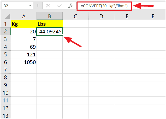

  3. Hit Enter, and bam! You’ve got your result in pounds. If you are converting 20 kilograms directly, your formula should be:
    =CONVERT(20, "kg", "lbm")
The result of using CONVERT function
